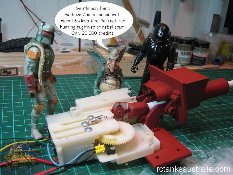

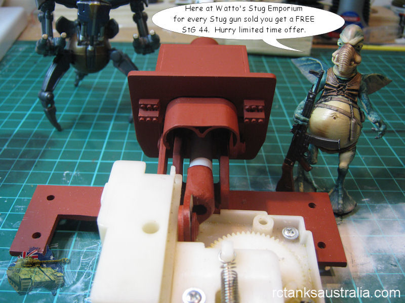

Since I wanted the model to have muzzle flash and recoil there was no choice but to discard the supplied barrel and replace it with one from Tank-Modellbau. Because of the limited space available I chose to use an Asiatam recoil unit to provide elevation & recoil of the main gun. The whole assembly came together as pictured below.

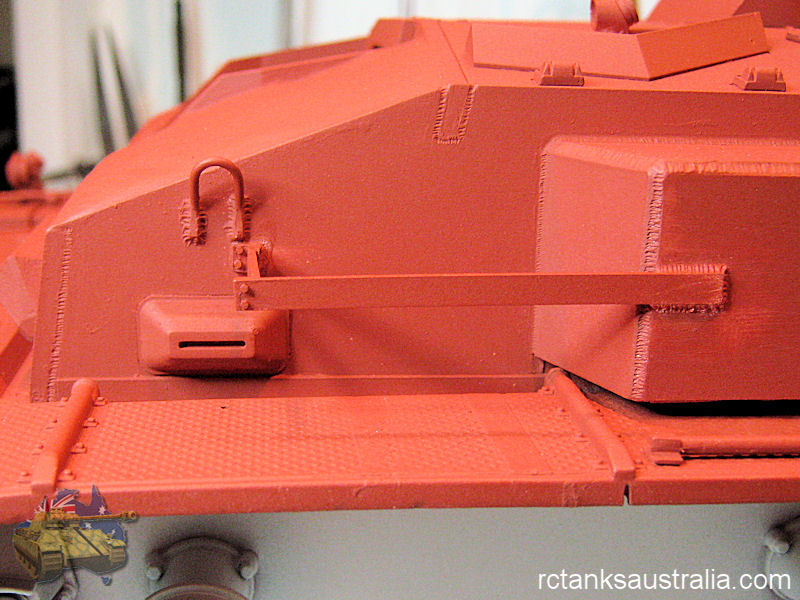

The next issue was the tools. The Stug F has a completely different positioning of tools compared to the Pz III Ausf H. Hence they all have to be removed. The problem here is that there is no commercially available 1/16 Pz III treadplate. The area were the tools were removed are clearly visible and will be to be hidden with stowage items, tree branches or snow. Also there is a very unique jack block, storage box combination on the F. Basically the storage box is located on a bracket above the jack block. However, the Stugs of Grossdeutschland have a different arrangement still. Ooooh more real modelling - no cut part A2 from Sprue A and stick to Part B2. The whole assembly had to be made and detailed.

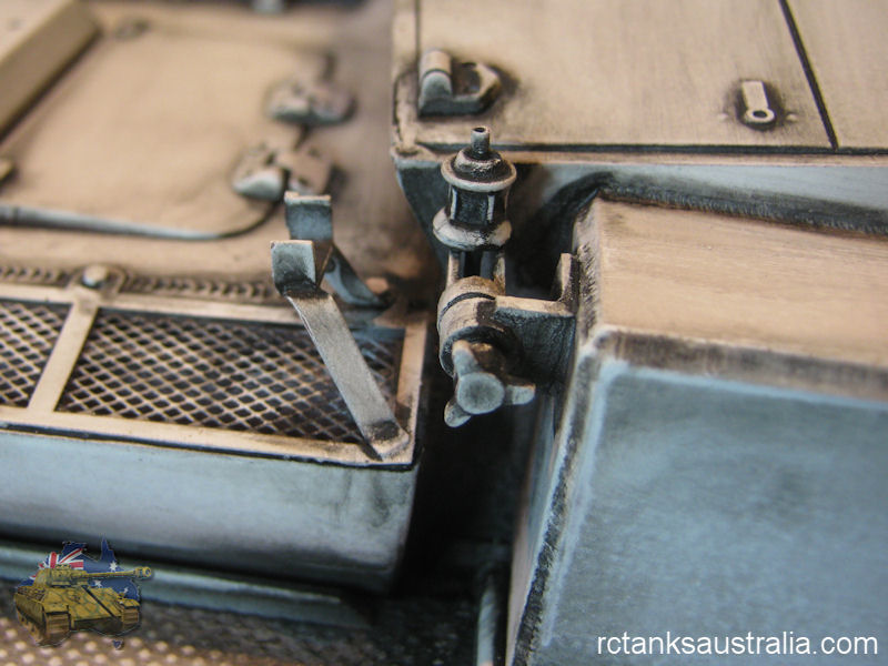

My biggest dissapointment detail wise was with the antenna holding troughs. It really seems like they were an afterthought. Furthermore the resin supports for the troughs on a working R/C model are just asking for trouble. I deceided to redo the supports in brass which as an added bonus can be soldered to the air intake screens.

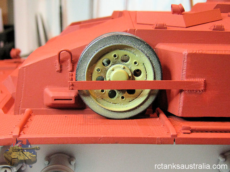

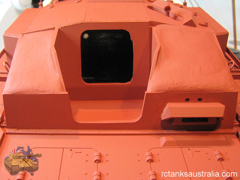

Concrete was added to protect the driver & loader. To do this I filled the majority of the cavity with milliput and to give the concrete texture I used Tamiya Polyester putty heavily thinned with acetone over the top, stippled with a deer foot brush.
Extra Wheel Storage:
These Stugs carried 4 extra wheels. Two were mounted forward, one on each side of the vehicle, again to provide additional protection for the driver & loader
To the rear another two wheels were added attached to the rear stowage rack. As seen in the pics at the start of this thread.

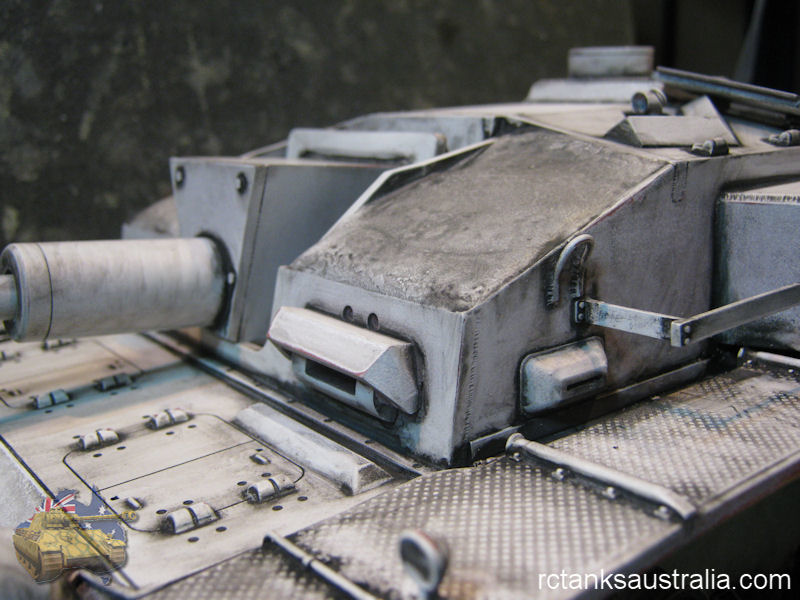

PRESHADING

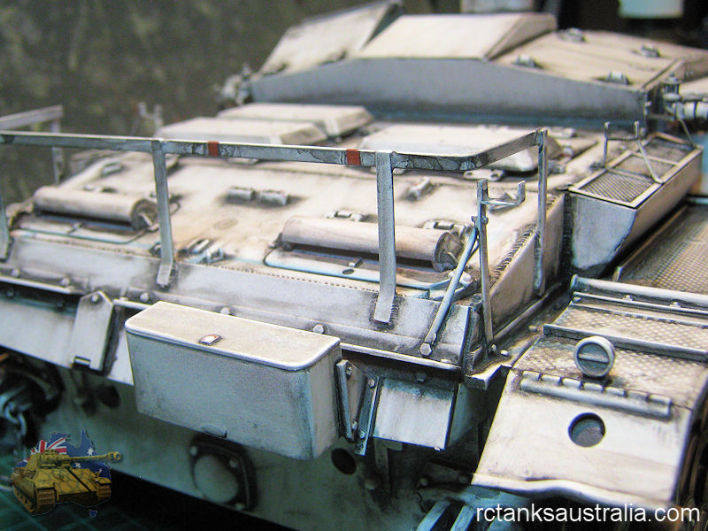

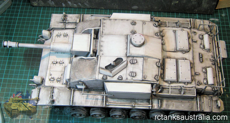

First Step: Here is a quick run down of my preshading technique. The first step after the construction is complete is to paint the model in a white undercoat. The white coat is usually over an initial undercoat of either light grey or red oxide. As you can see the Stug had an initial undercoat of red oxide. You need this first undercoat to spot all the blemishes in the model (essential if working with resin). I use White Knight Super Primer from Bunnings. I have had ZERO issues with this primer as it works well on plastics & metal. I DO NOT use any of the primers produced by modelling companies, Tamiya, Testors,... The main reason for this is that they will not stand up to my technique and will come off in the next set of steps. White Knight primer sticks and tends to stay stuck.
When you apply the white undercoat you do not need to cover the model 100%. If the white does not get into all the nooks & crannies thats fine cos that is exactly the effect that you want. Once finished let this coat dry for at least 24hrs.
Second Step: Once the white undercoat is dry it is time to apply black into the shadows. You can do this either by a black wash, spraying black or a combination of both. For this step I use an acrylic paint either Vallejo Black for figures or Tamiya XF-1 black for vehicles. For the Stug I applied a black wash to make sure the black got into all of the crevices followed by airbrushing black along all the corners and edges. Your model will now look absolutely horrible. Let it at least dry to touch before going on to the next step.
Third Step: This is the money step. Get a cloth rag and splash on some methylated spirits now attempt to clean off all the black. As the cloth moves across the model it will take the black off all the raised parts (much like dry brushing) and leave black in all the crevices. Swap from a cloth to one of those applicators that the wife, girlfriend, mistress... uses for their eye makeup to go over all the fine detail parts.
User avatar
phyrephish
King Tiger Commander
Posts: 135
Joined: Sun Mar 26, 2017 10:24 am
Re: Profiline Stug III Ausf F Build & Review
Post by phyrephish » Tue Mar 28, 2017 8:37 pm
PRESHADING RESULTS:

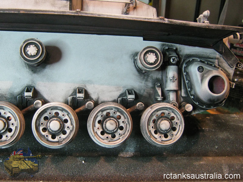

Below are some PzIV sprockets that have been painted with the preshading technique. The effect is subtle and can easily vanish if you apply too much of the top colour (in this case Dunkelgelb). Preshading doesn't replace the usual black washes if done right it should enhance your washes.
I think that I may of applied too much Dunkelgelb over the Stug as the preshading appears lost on most of the upper surface. Below are some areas where the preshading effect is most prominent.
Inside Hatches
Muzzle Break
Aerial Mount
Overall

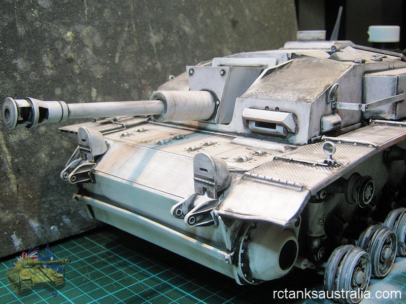

Before the decals were applied the camouflage was 'toned down' by spraying a fine 'blending' coat of 50% Dunkelgelb 50% Olivgrun over the entire model. When this was dry the entire model was given a coat of Hi-Gloss varnish. The decals were applied over this Hi-Gloss coat. The unit number (105) decals I originally planned to use were too small for the sides so I am awaiting some new unit numbers before moving on.

Been a while update wise but things are still progressing. Here are a few shots of the stage the Stug is at now. Just a bit of weathering needed on the stowage items, some impact tracks and a few final sprays and it should be done.
