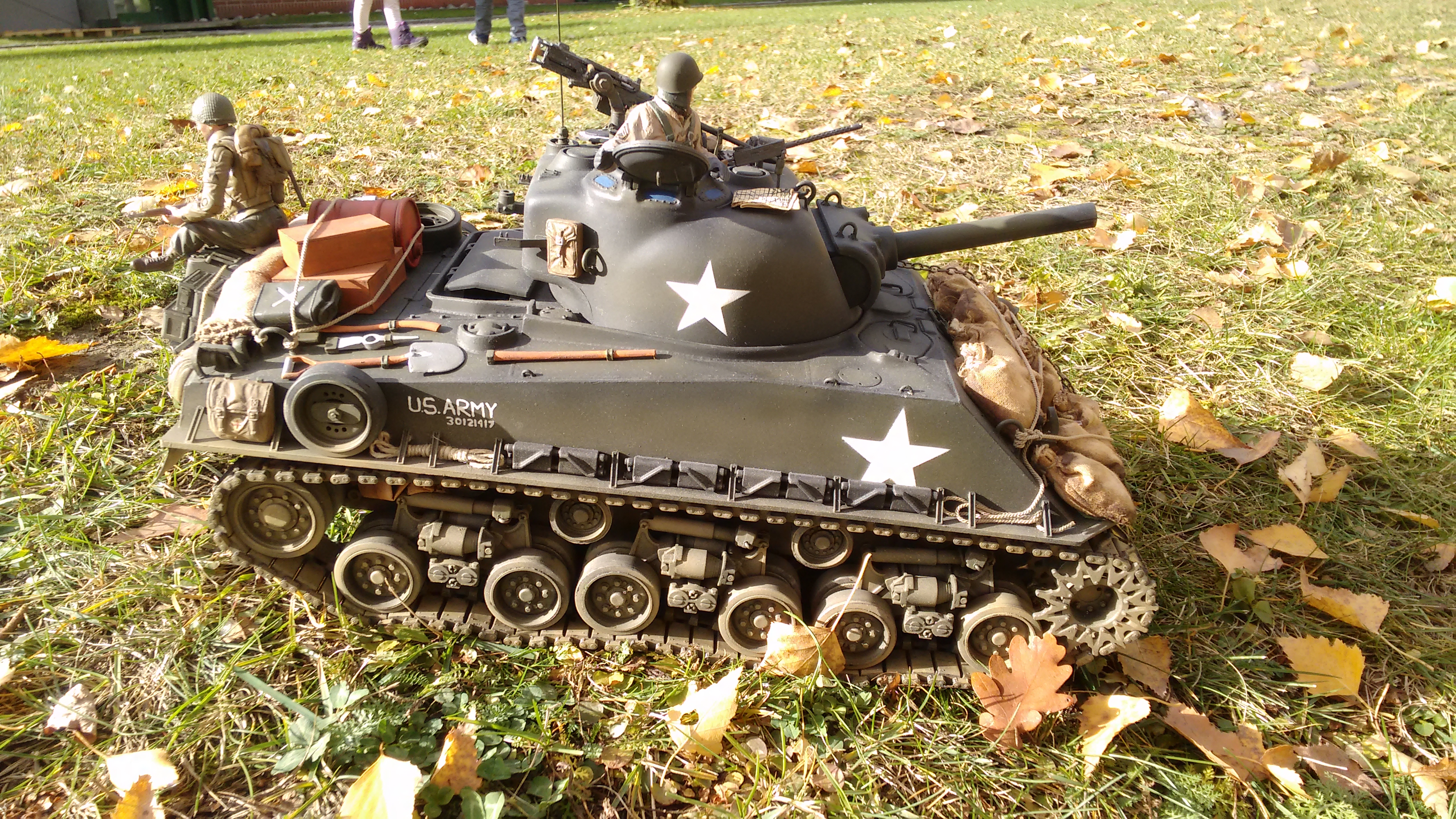

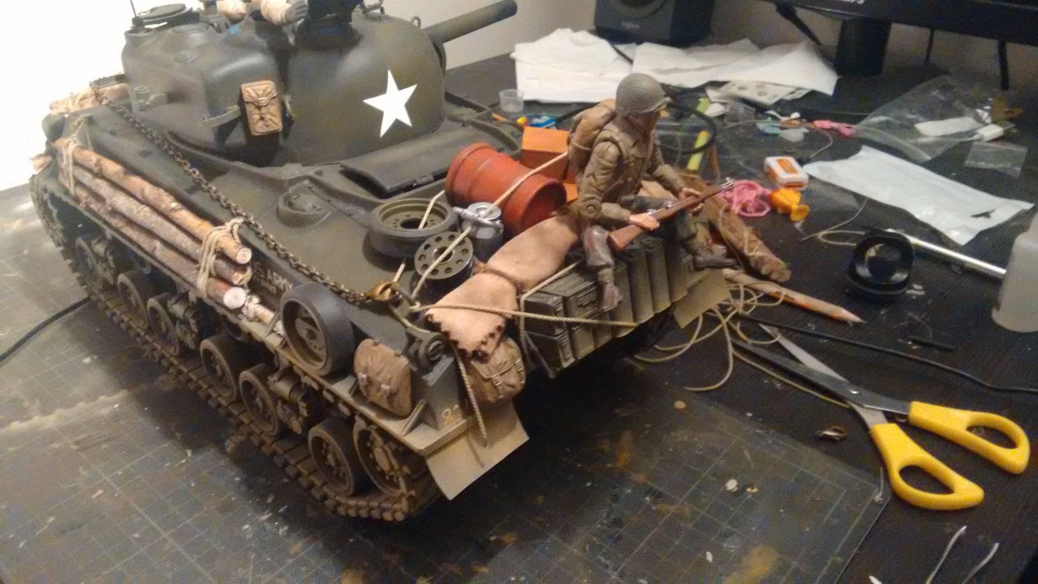

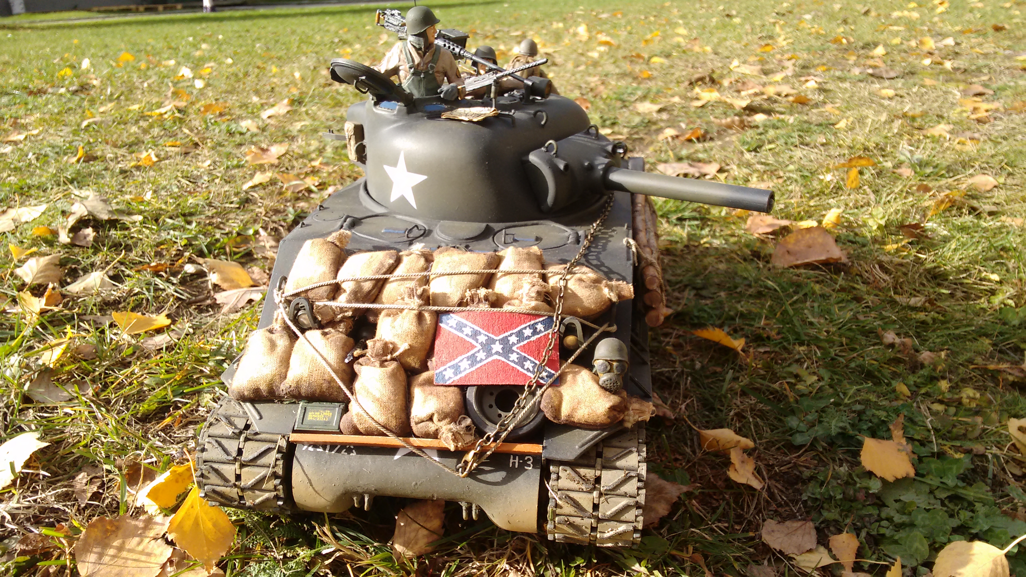

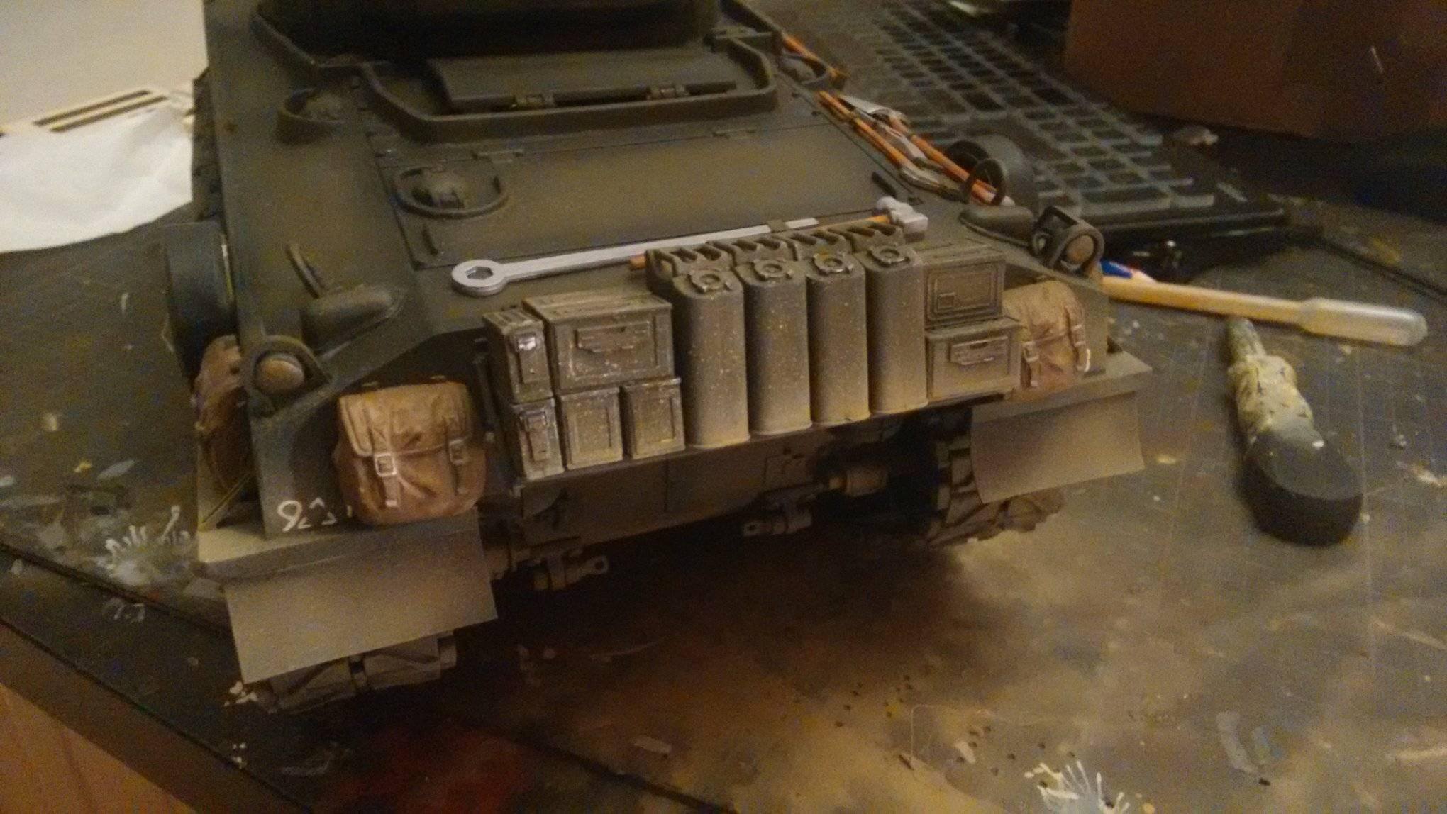

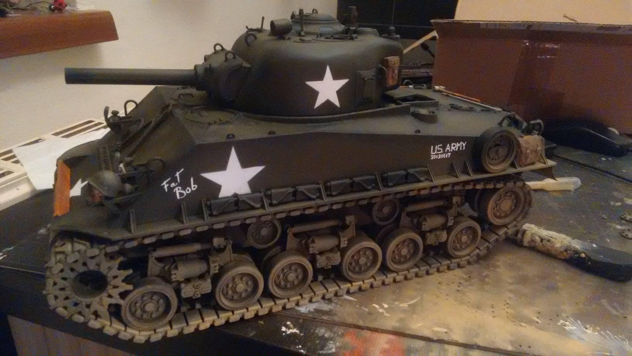

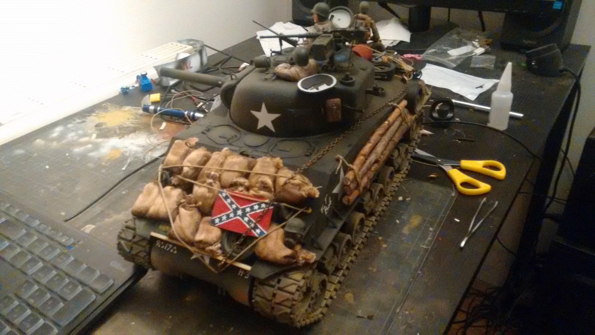

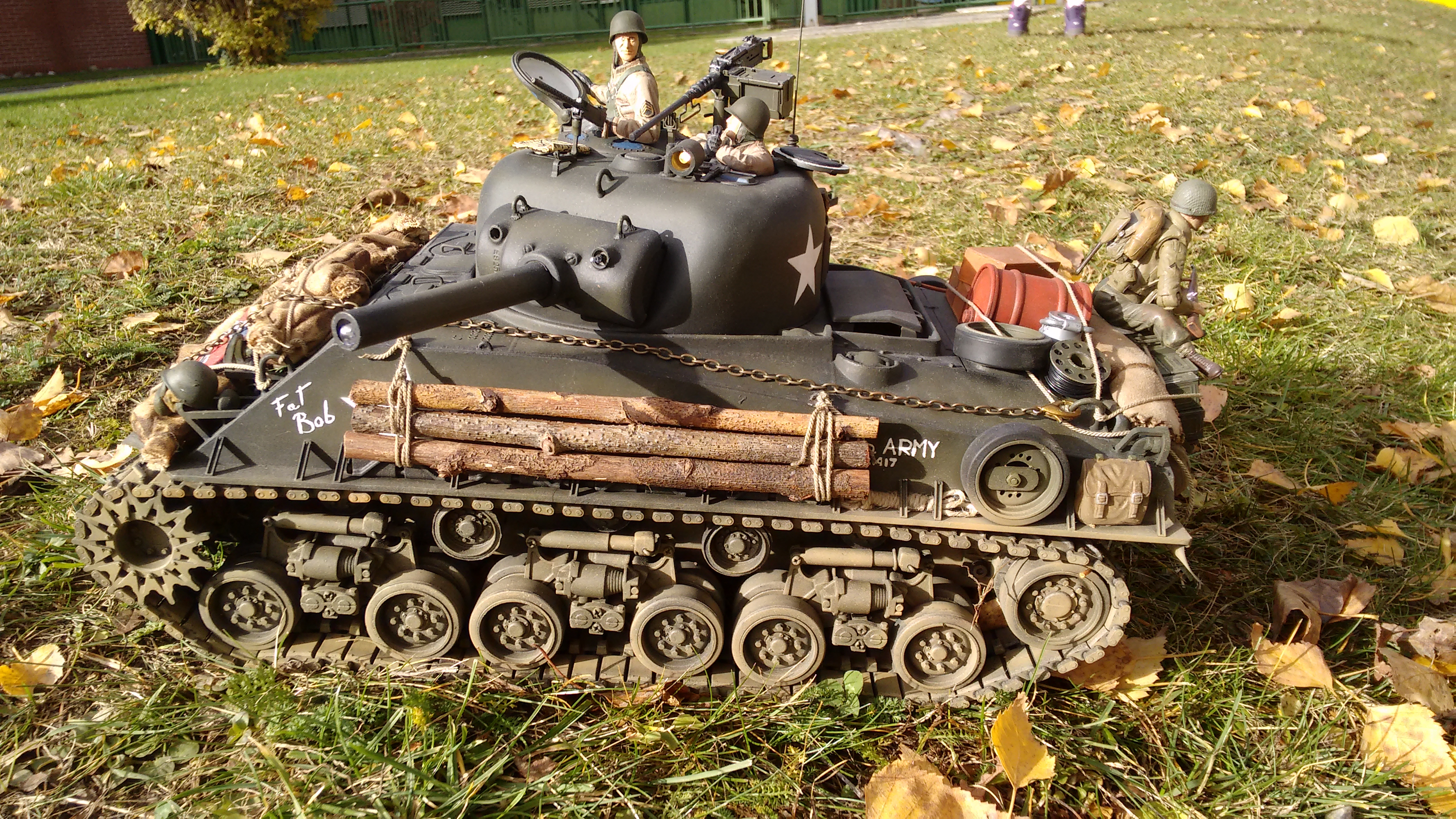

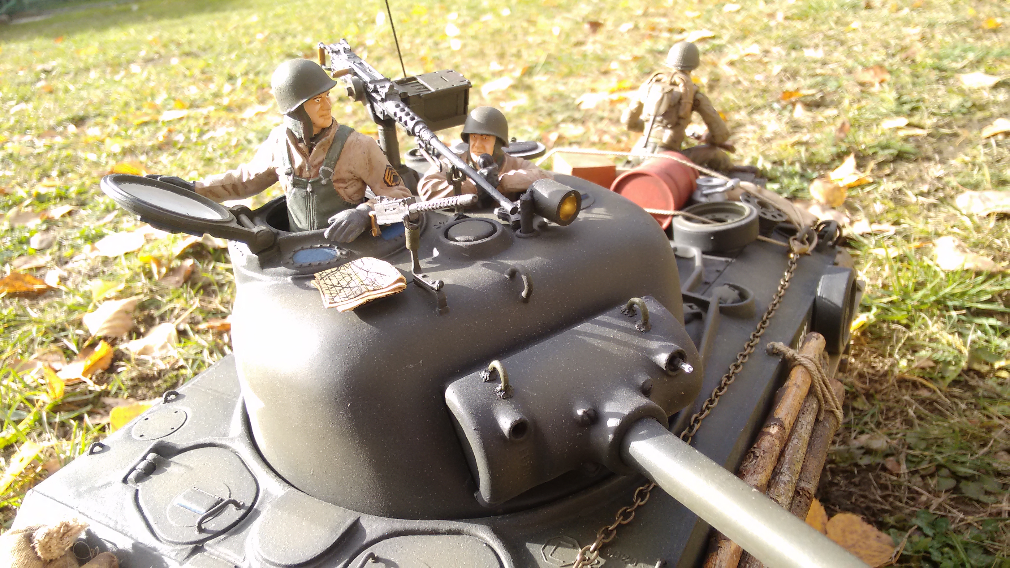

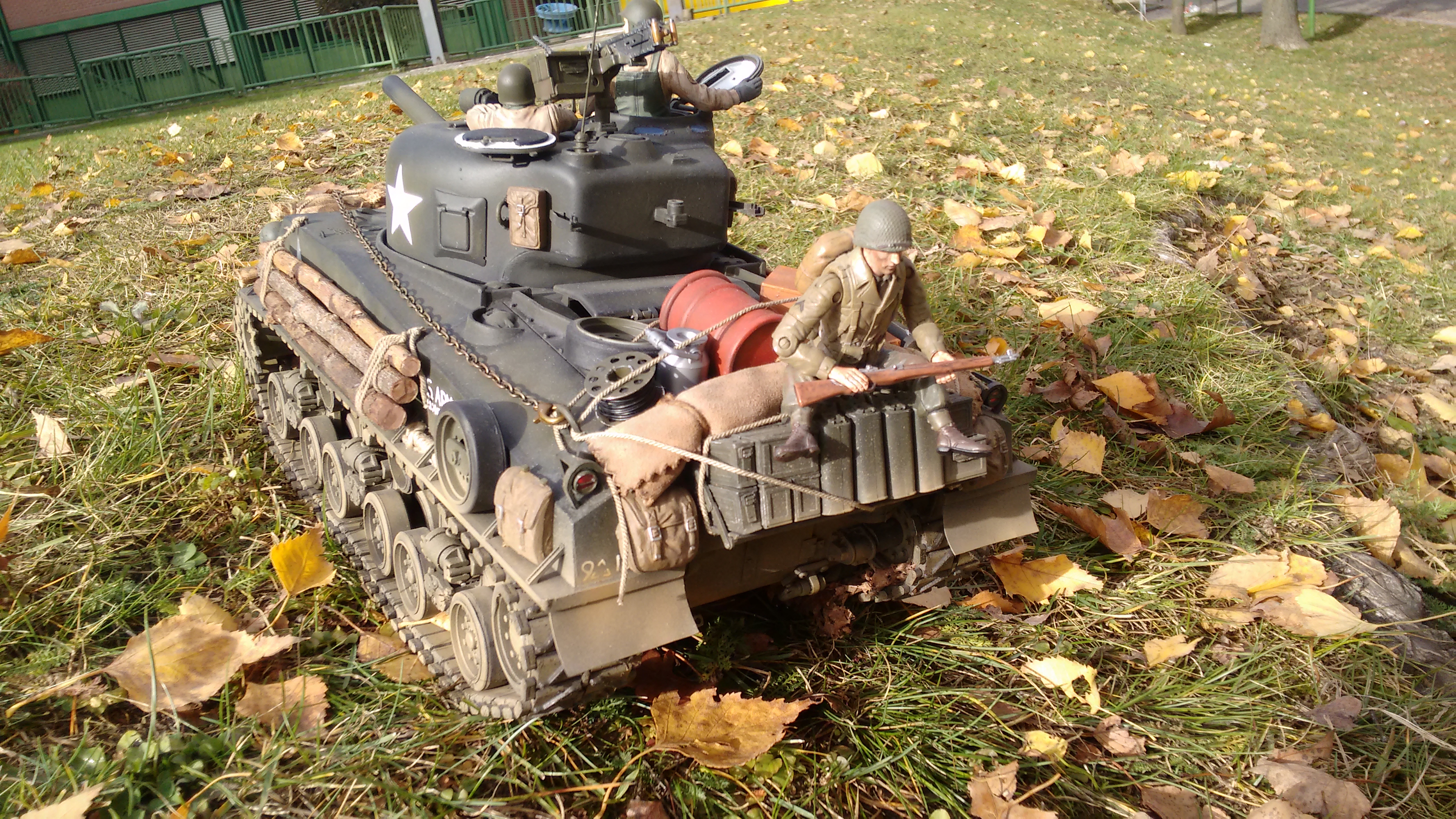

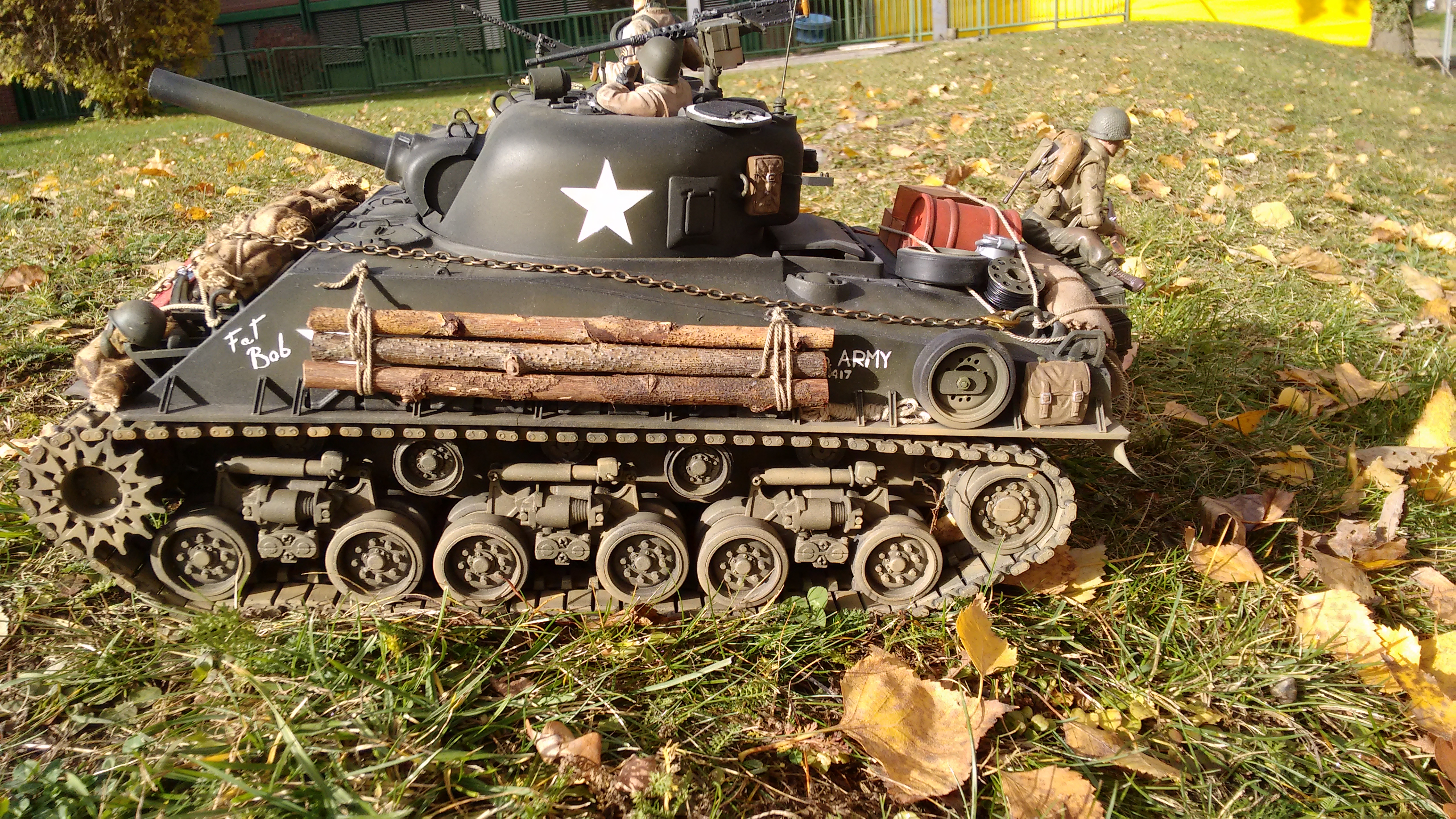

Hi everyone. This is still in a never ending work in progress, but Im pretty happy of how it looks so far. Over a stock tamiya sherman, I have added a working travel barrel lock, opening motor hatch, opening tank commander hatch, I instaled bearings in the idler wheels (thats the weakest part of the kit) and also some heatshrink tube covering the returnr rollers, which are prone to wear.
And then I added some more extra bits like towing hooks, lifting hooks, working turret machine gun, working searchlight and its powered by an ASP2
105mm Sherman.

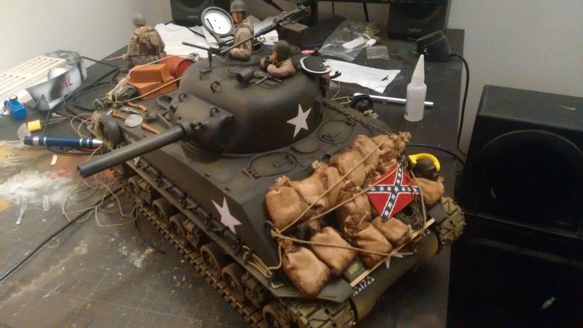

More photos:
