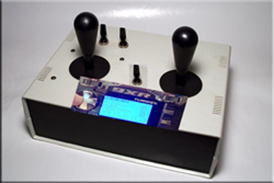

So I want to build a DIY remote control housing box like the one I’ve pictured below, installing all the guts from the 9XR PRO radio with the screen and switches mounted approximately as shown. There will be plenty of room to remount everything so that’s not an issue.
Now, notice the two joysticks instead of the usual two gimbal sticks. I am wanting to fit something more like the Arcade type joysticks as shown.
proposed design.jpg (73.92 KiB) Viewed 25541 times
I was wanting to use the joysticks like these though not necessarily these, just some like them that would be compatible.

HI There
There should be no problems doing what you want to do AS LONG AS the replacement joysticks operate the same way as the radio gimbals. Your first example joystick from element14 would not work as it is a switch operating unit. There are 4 independent switches which means there is only ON/OFF in each direction you would have no speed control whatsoever.
You need to find a replacement joystick that uses 2 independent potentiometers. I think the post in the 9X are 5k pots so - all your replacement joysticks would need to be equipped with 5k pots.
This example is more of what you need
https://core-electronics.com.au/2-axis-joystick.html
BUT it uses 10k pots - the 9X "MAY" use 10k pots I'm not 100% sure but from memory I think I came up with 5k using my (dodgy) multimeter.
There are plenty of 9X schematics on the web and certainly someone will know for sure on the 9X forum (hell there will certainly be someone who has already done what you want to do)
SO first step would be to find a joystick with pots not switches
